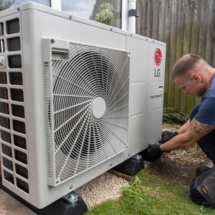

Which house suits a Heat Pump?
Air-to-water heat pumps can work in most homes, with running costs similar to (or often cheaper than) gas boilers. However, an in-depth survey is needed to measure the property, confirm the thermal values of the different elements of the property, measure the radiators, if possible confirm existing pipework sizing, age, condition and location. You’ll need to carry out a survey and room-by-room heat loss assessment in the property to confirm the size required and this could take from 2 hours. The size of the radiators and design flow temperature is also an important consideration. Larger radiators would mean lower flow temperatures and lower running costs, but this needs to be balanced against available space and install costs.
Suitable properties will have:

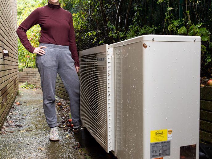

- Space for the outdoor unit (similar in size to two washing machines side by side)
- Good airflow and clear space around the unit – bear in mind the local environment will get colder and that will impact plants nearby or in the direct air flow
- Drainage or soakaway for condensation and defrost water
- Suitable space to comply with noise regulations
- Space for a hot water storage cylinder
- Each room will also need an adequately sized radiator

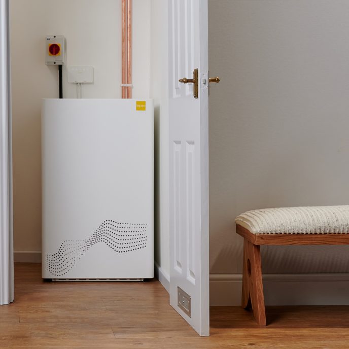

Which house suits a Zero Emissions Boiler?
In some circumstances heat pumps aren’t suitable for properties – and that can be for a variety of reasons. But if you’re on the path to a greener home and can’t install a heat pump and air-to-air heat pumps have also been discounted, don’t lose hope; there are alternatives. A Zero Emission Boiler (ZEB) acts like a heat battery; powered by electricity, it can store energy within a thermal core until it’s needed for heating the home or hot water. ZEBs can fit into existing heating systems, whether they use radiators, underfloor heating and water tanks. However, while it is 100% efficient it can be up to 4 times more expensive to run than a heat pump and so needs careful consideration. They work best in very low heat demand properties with cheaper time-of-use tariffs.
- A heat-demand of less than 12,000kWh pa fuel consumption to maintain acceptable running costs
- Indoor space for the ZEB unit already
- Already has a hot water cylinder (or the capacity to install one)
- Smart meter and ability to use a time of use tariff
